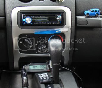

I keep in the Jeep an Autel reader 4 in 1 maxitrip 100. It can do the code reader and display extra gauges etc.
I like to see my FWT or water temp and correct voltage readings etc.
50249[/ATTACH]"]

I dont need anything fancy but like the small footprint of the Tp-100 display unit.
