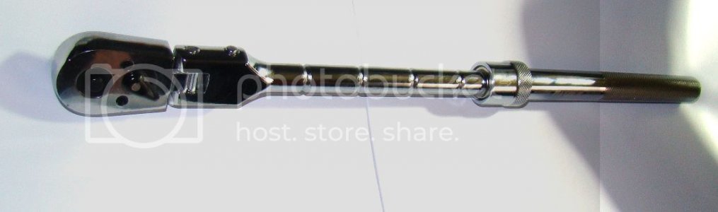

Sometimes the shorter handle ratchets are not long enough.
I have one that is extendable, and often no need for a breaker bar.
51659[/ATTACH]"]

For extra leverage, I use one of the pieces of the the two-piece handle for my floor jack which fits easily over a socket wrench....
