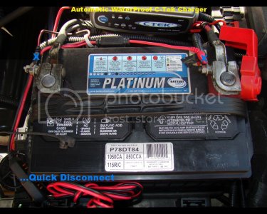

Ya I hate it when u turn the key and you hear err crank crank then silence.

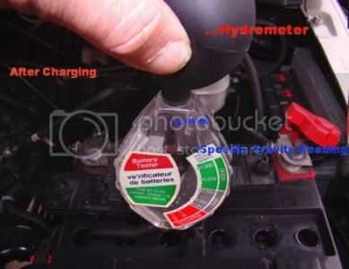

These are $5:
51677[/ATTACH]"]
Can you plug in a charger overnight? I wish I could come over..& bring a few tools....to help you!
I would give ya a spare 800 CCA that passes a load test too.
51679[/ATTACH]"]
And then load test it for 10 seconds... then ya know if it's good the bad or the dead. :icon_twisted:
