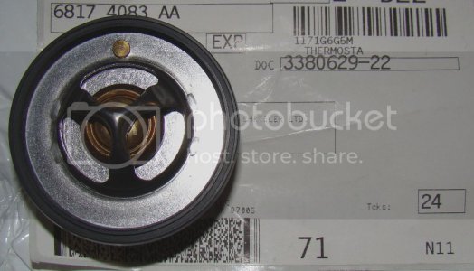

And The OEM Thermostat is next..
50396[/ATTACH]"]
Nothing Wrong with Current Thermostat However a new one is still going in.:party52:
