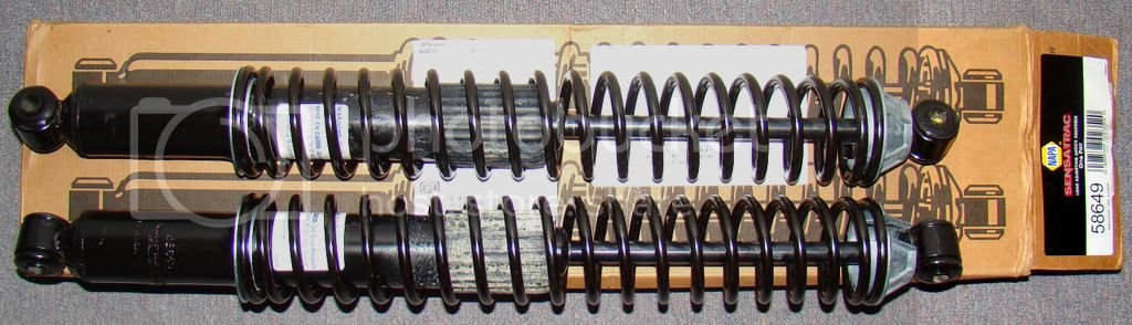

How do you test your rear hockey pucks?
Easy..Just experience one blown out Bilstien shock and big bump= bang! :gr_grin:
What a mess..:blah:
59576[/ATTACH]"]
I have the replacements ready to go in sometime real soon! :gr_grin:
59578[/ATTACH]"]
Got cardboard under left rear wheel, to keep the drips off the driveway.:favorites68:

How many miles did you have on it?
I blew 2 or 3 rear Bilsteins...never knew why. OME ones have so far outlasted them.
What a mess..:blah:
59580[/ATTACH]"]
59582[/ATTACH]"]
The cause is the incorrect shock length since Bilstein does not make a lifted rear shock for a KJ and why the OME's don't blowout like this since they are the correct length(un-modified OME lifts only).
My rear 7100's have been flawless for over 31,000 miles but measured correctly for my shocks to prevent fully compressing them.

Don't know how many miles HJ, maybe 30 k & 5 years IDK, they became spongy last fall.
This time one side was a complete gusher !

I love the OME ones...idk what I'll go with when the time comes to replace them.
59584[/ATTACH]"]
Post some follow up. Debating throwing a set of those in the minivan.
