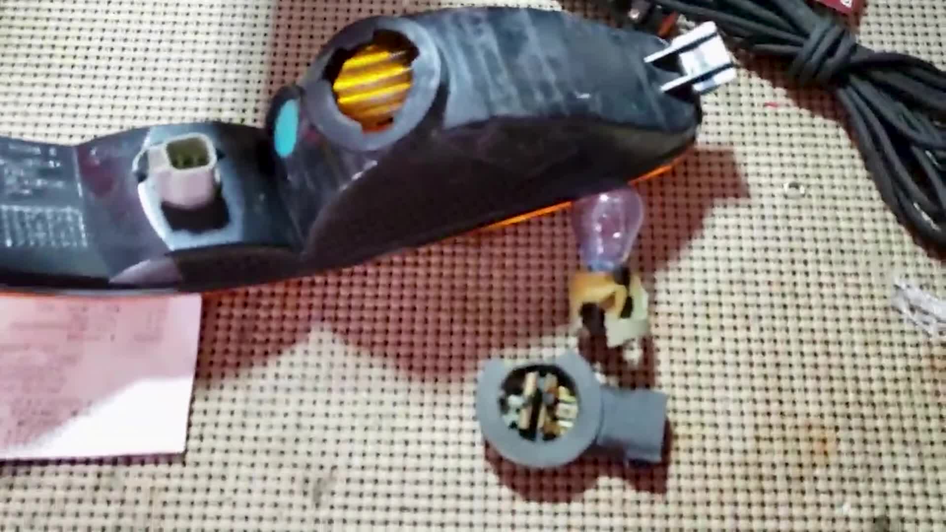

Started a simple blinker bulb change and discovered otherwise. Turns out I need to replace the socket.
Found the Mopar part
Autozone seems to have it for a more more reasonable price.
