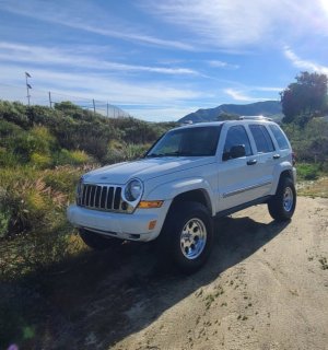

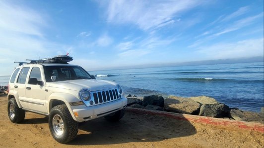

Hello, got a '05 Limited KJ for a decent deal last year and new to the Liberty family. I'm wanting to use it for overlanding this year and have been looking around for lift suggestions as stuff gets a bit more overwhelming the more you read and look into it lol.
I don't plan on doing crazy off-roading with it. Mainly going on logging roads/rough gravel roads. I want to have something that's at least better than stock since my suspension I have now feels shot. Hoping anyone has suggestions for a modest lift.
I used Rocky Road Outfitters...they have a liberty 3" lift, with JBAOFFROAD.COM upper control arms and you will get awesome ground clearance.
