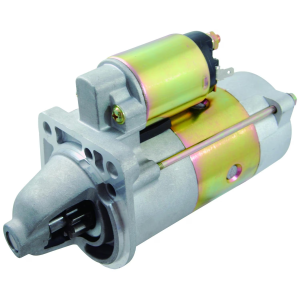

Sounds like a bad starter solenoid or bad starter motor based on what you described. Best to just replace the whole starter.
Autozone has them with lifetime warranty.
Duralast Gold New Starter DLG5223​
Part #DLG5223
