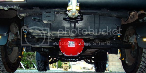

One thing about the gas tank skid is that it likes to trap all the dirt and mud.
In the corner where the small cut away are visible right and left side, I ran the hose full blast with warm water and was shocked what came out the back. (yuk)
