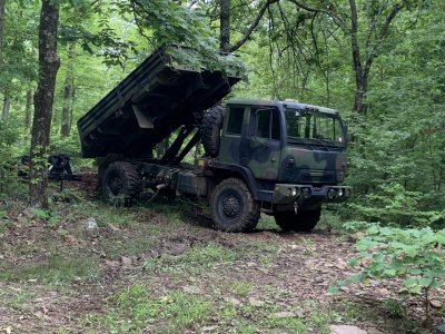

Maybe a rear locker is in your future - made a big difference for me
That looks like fun - military surplus I assume?
Yes. 1998 M1078 LMTV with a dump bed conversion. Short wheel base with the cab over. Good for navigating in tight spots. Air spring assist. Hauled 55 loads of gravel out of the creek this summer.
