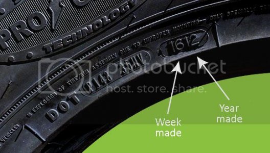

Sorry BUT...I hope your next purchase may be some new tires, after viewing Wrangler SR-A on your passenger front...scary, worst tire ever.
You should also read your date codes how old are those tires?
56483[/ATTACH]"]
NBC Story: Link: Dangerous Tires: Aged Tires Linked to Auto Accidents Video - ABC News
