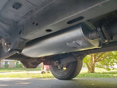

Replaced the muffler with Junior....actually let him do most of it. The 18 year old loved it...warms my heart and saves my back. Jeep is running with a "put put put put" sound still. Thoughts? Plugs maybe...
