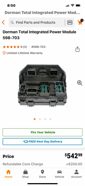

About $550 + core.
Still seems high to me for what it is. But it truly is plug and play. So there’s that.
