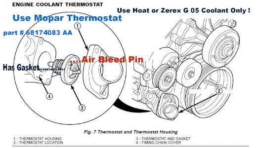

Sport thermostat? Only use a Mopar thermostat it has the bleed air hole and built in gasket part # 6817 4083 AA
Pressure test the recovery tank @15psi (needs adapters) mopar cap should be 16psi.
If any leak or air is entering the coolant tank/or system it wont pressurize properly.
