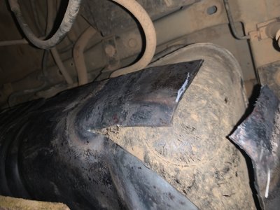

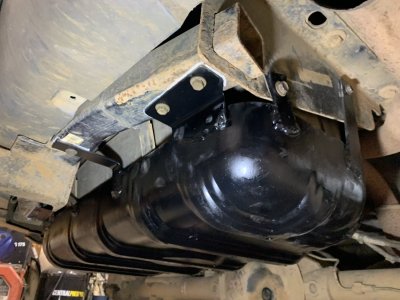

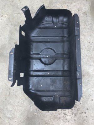

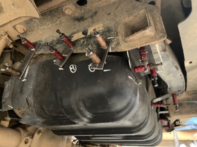

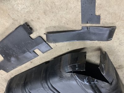

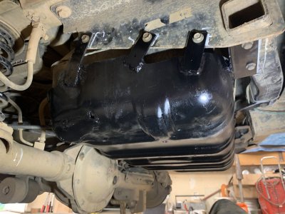

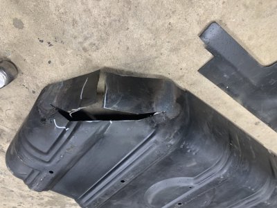

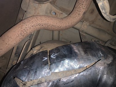

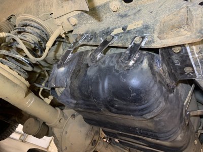

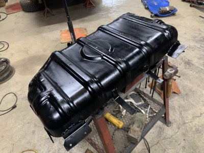

The wrangler to liberty tank skid plate went well. It is not something you can do in your garage with a propane torch. But if you are a fabricator its pretty straight forward. The short version. I mounted it to my trailer hitch. All I needed was the pan. I cut off the wrangler mounting. Made my own.
