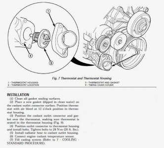

You need the OEM Thermostat and install & align it correctly.
2,702
241
Alignment is very important! That bleed "jiggle" valve needs to be at 12 o'clock or you can trap air. I know people who used a non-bleed t stat but drilled an 1/8" hole and positioned at 12 o'clock. worked fine.
