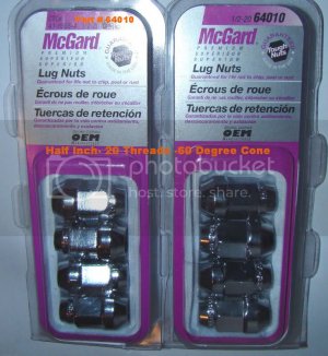

1/2 X 20 is correct ...60 degree cone??
Do they look like this?
54523[/ATTACH]"]

They are 1/2x20 with the 60 degree cone but they are not bulged at all like the stock nuts...it almost looks like i should have a washer in there so it actually holds the tire to the vehicle... they dont look like the ones you posted, if you click my link up top you can see the exact ones i got
I forgot to say Welcome to the forums BTW..!!
I would use the stock lugs for now as the Dorman's don't look like the proper 60 degree McGuards.
You could take your Dorman into a local parts store and compare/find the right ones ASAP.
One thing is for sure if you grab a set of 64010 McGuards you now have quality rust free lugs, that stay correctly tight! :gr_grin:

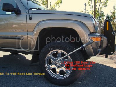

I wanted to add about the Torque specs of 85 to 115 foot pounds.
54525[/ATTACH]"]
My torque wrench stays in the Jeep and I check lugs frequently!
If you do not have a proper torque wrench, I can help you spend some more $ while you are at the parts store tomorrow! :icon_lol:
