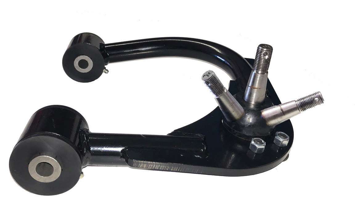

Looking to replace the front upper control arms while doing my lift and was looking at the either the Mevotech TTX, Mevotech GK3198, or Moog RK3198.
Anyone have any comments or recommendations on the ones mentioned above?
I would get JBAs but the cost to import them here in Canada is ridiculous.
2005 Jeep Liberty Limited
There's a new company I found just recently offering lifted UCAs for the Liberty (1-4 inches of lift), they do look like JBA knockoffs, removable/greasable ball joints and bushings, just like JBAs. I'm in Canada too so couldn't justify JBAs with the springs, shocks and other parts I ordered recently. The brand is "Deeke's" and look very similar to the JBAs. You can find them on American Amazon, but not Canadian. I just ordered a set tonight to try them out. They were $150USD, so about $200CAD, but there is a $15 coupon available on them right now to bring it down to $135USD. With shipping and all it worked out to about $250CAD for me. I was skeptical with that price point so low, it was cheaper than many OEM replacement sets, but I figure they are worth a try, with Amazon's good return policy. I did also see in the reviews that someone posted a photo of a Liberty suspension with the arms installed, and the angles looked very good for having a lift (spacer, not spring) with their suspension at full droop. I plan on installing them this weekend with my new OME springs and Rancho shocks upfront (had BDS springs in the rear already). I did a cheap lift mashed up with various parts 6 months ago, BDS springs in the back and a top plate and clevis lift on new OEM coilovers up front, sat at about 20.5" upfront when done, and 22" rear. The BDS springs have held up very well, but the front OEM springs have already sagged 1 inch in 6 months! So I finally bit the bullet and ordered some OME 927 springs and Rancho shocks for upfront, and then decided to try out these new Deeke's brand lift UCAs. I couldn't find any information on them on this forum, other than one post asking if anyone has tried them, and it appears no one on here has yet.
They do look exactly like the JBA arms at 1/3rd the price, I swear some Chinese manufacturer just bought a set of JBA arms, scanned them, and replicated then, right down to the removable ball joint design.
I don't quite expect them to be as high of quality as JBA arms, and I believe JBA offers a lifetime warranty vs the only 1 year on these, but I figure they are worth trying. Worst case I'll put the OEM arms back on if there is issues with alignment, but they make arms for Tacoma's and Cherokees as well and the reviews seemed good on them. I don't like that they appear to have stolen JBAs design, I would prefer to support the USA products, but I couldn't justify $800-1000CAD to order the JBA arms. They so appear to be near identical copies, but likely using lower quality metals, but if they last me a few years and help correct the angles, I'll be happy with them. They appear to be fairly good quality from the photos I've seen of them up close, the welds look pretty good honestly.
I'll try to remember to update everyone on here who might be curious about them after I get them installed this weekend.
Im attaching the screen shots of them. The one with them installed is on a KJ Liberty. Looks like a good fit actually. Some extra clearance too between the spring and UCA it looks like. You can see the aluminum spacer at the bottom of their coil spring in the photo as well.
I'm guessing part of the low price point is due to it being a new product, and the company maybe trying to break into the market. No idea where I would get the replacement ball joints though, outside of contacting the company directly, but I'm not entirely convinced this jeep will outlive a new set of ball joints anyway, assuming they're good quality. They should arrive on Thursday, pretty quick shipping from US Amazon to BC Canada, then I'll start pulling the front suspension apart Friday night, and should have it all back together and done Saturday.

They've been mentioned on here before. I think we've just been waiting for a guinea pig and your it!;)
Judging by the photo I posted from a review of it from amazon on a KJ, they look like a good fit. Angles look good considering they're all full droop on jack stands. It'll be interesting to see how it goes at the tire shop after when I get the alignment done, that's when I'll actually find out how well they're made. Guess I am the guinea pig on these!
Looks like they have separate arms as well for KKs.

They are probably chevy balljoints that fit 10-15 model years of half-ton pickups. Thats what they are for my RRO arms. My balljoints have over 10 years on them now.
Cool, good to know. I imagine those are stronger than the OEM ones. I do question these ball joints a bit, as the sizing may be for a Chevy half ton, but I'm not convinced they are made of top quality materials at the price point they are. It looks like they could possibly accept a JBA ball joint though, judging by the bolt in design and pattern, so I may see down the road if the JBA joints can drop in, if I start noticing issues. They should arrive in 2 days, then go in Saturday.

I did find out a bit more about these "Deeke's" control arms I have coming tomorrow, it sounds like a few people did snap the grease fittings off of the connection point for greasing the control arm bushings, so that is one mark against them already. I imagine they could be replaced and fitted with some better quality ones by drilling a new hole and plugging the old broken off zerk, or by drilling it out and fitting a new one in its place (it looks like 2 guys in the reviews snapped the grease fitting off, but the threaded base remained in the arm).
At least now that I know about this, I can be very careful when greasing them and doing anything with the fittings. I imagine these guys were unaware of this issue and just applied a bit too much force to them, but clearly the grease zerks are not very good quality, at least the ones for the bushings. It doesn't bode well, but the rest of the arms look strong and welded well, and this was only mentioned in 2 out of 21 reviews, and both reviews mentioning the broken fitting were Cherokee arms, none of the Liberty arm reviews mentioned breaking the grease zerks off.
It does look like maybe, a JBA ball joint would bolt up to this arm, so at least if these joints don't last long, I could always drop in a JBA ball joint potentially and still be ahead by a few hundred dollars.
