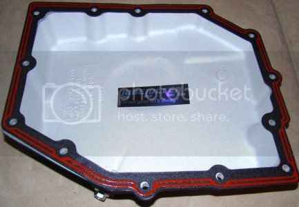

:icon_idea: I installed a PML 1.5 quart over stock Trans Pan for the 42RLE do your have the 42RLE or 45RFE? Never had a temp light since. :party52:
Anyways if you have the 42RLE the new aluminum pan will keep things cooler and the extra 1.5 quart of ATF+4 helps!
A drain plug is standard and allows easy drain & refill when u need to. You can also install a trans temp sensor in new pan. Fits above OEM skid plate perfectly.
YourCovers.com 42RLE Transmission Pan
I used a Lubelocker gasket and has been absolutely leak free. Unlike the te OEM pan which was constantly weeping and the main reason (beides heat) I went to the PML.

That's awesome, I will definitely buy one as soon as possible. My wife would kill me if I bought it right now though... Within the past two weeks I've bought an ome 2.5 lift, duratracs, paid for the service, and did the back breaks/rotors lol

For off road, I wish there was a switch that would force the electrical fans to stay on high speed, to help keep things cool....(hmm where is the mod for this ?) (disconnect temp sensor wires LOL)
Glad u like the PML...it's COOL..!! er..
I painted mine black..high temp -flat...not gloss..
50097[/ATTACH]"]
PS for everything else there is MasterCard ...and the wife wont know at least for 30 days ! LOL....

If you're going to replace the oil pan I'd drill out a spot in it for an auxiliary temperature sensor.
The Liberty seems to lack one.

PML can machine hole / threads for temp sensor I believe at time of ordering.
