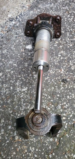

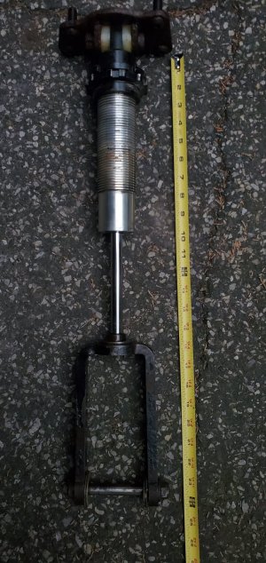

Bottom of the coilover snapped in the JBA clevis and finally got around to getting it out to fully inspect it. Found out that it was threaded in. Finally some good news. Digging through here and the archives of Lostjeeps.com, found more good information. So now pretty confident in my next steps.
First is to drill out the broken piece and separate the top plate from the coilover. They have been soaking in PB Blaster.
