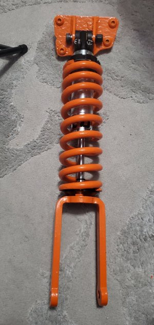

Almost there. Got it assembled for fitment before, coincidentally, lubing the threads with orange thread locker.
Annoying that paint shops wouldn't take small jobs so had to rattle can it.

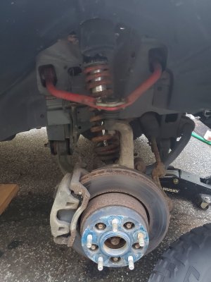

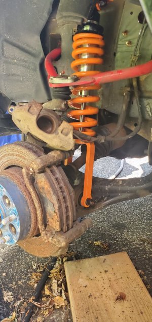

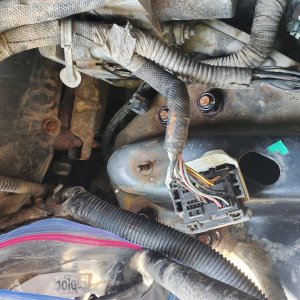

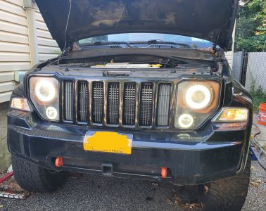

Parasitic draw zeroed the battery. Would not even trickle charge so had to get a new one... but Oddball fired right up with no hesitation! Made some funny movements but I'm chalking that up to flat spots on the tires.
All turned around now and going in for the passenger. Easier but more annoying since this one isn't snapped. I'm going to have to take out the upper A-Arm. So much room for activities in the engine bay compared to the drivers side.

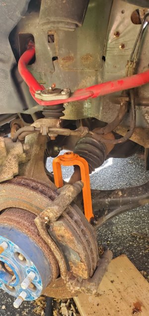

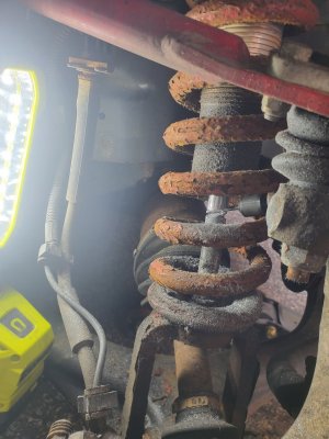

May 31, 2020
80
49

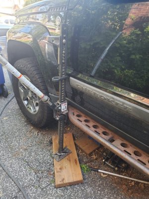

Just a little cheating, but now it is out and ready for cleaning and painting.

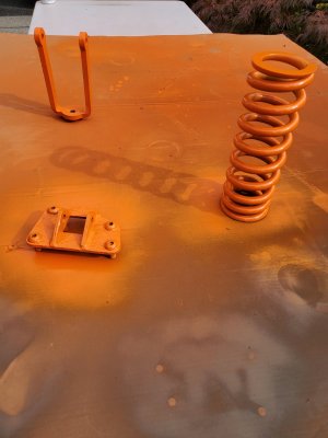

May 31, 2020
80
49
Passenger side spring and perches painted, just need to get it in there. Hopefully before the end of the weekend.
