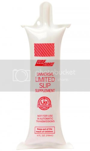

I've tried the lubeguard friction modifier as well.
9,242
1,882
Ya I have used the LubeGard Limited slip before too..
There is just something that feels so wrong about cutting the tip off & then squeezing it..LOL.. :happy175:
58748[/ATTACH]"]
