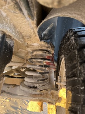

I’ll be measuring soon. Wife is off work in a moment. Truck is warming up. Go out it on the road and take the measurement and will show a picture of the measurement for you Tom.
NorthernGuy93
Jan 17, 2022
29
Measure your shock ???
No need when you give specs we can then tell how high you are sitting and know what would work best
So right about 21” dead on almost.

Hey Tom. Just wondering if you thought about my shocks overnight? I want to keep it about 2.5 “ lift. I know you suggested Bilstien. Can I get part numbers from you. And coils also too. Please. Your the best.
2 inches of lift
sagged 1/2 , without knowing age of springs not too bad
So let me think a minute on right shock length for the rear
3,643
I have a real job so been there and not at my computer LOL
Should be , retired 3 times so far and now working another job : )
rear OME coils for a KJ are 948s
IF and a big IF you have rear bumpstops in go for the Bilsteins 24-185660
