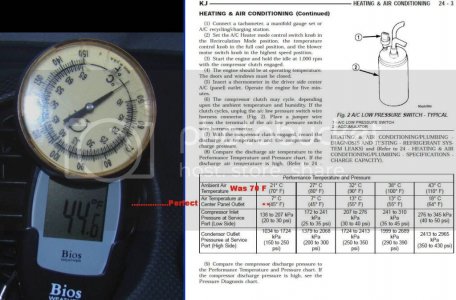

Here is how to tell if your Jeep is "Cool" or not!~ :icon_lol:
52459[/ATTACH]"]
Looks My A/C is working to specs! :party52:

Do the temp probe test first, but yours may need high & low side pressure gauge testing.
At 100F you are expected to see 55F out of the vent as specified above.

Got a new digital thermometer and discovered that mine is pumping 40F air at the high fan speed. Turning the fan down to the lowest speed dropped the temperature to 36F. I forgot to put the thing in recirculation mode, so I'll have to remember to do that next time and see how much difference it makes.
