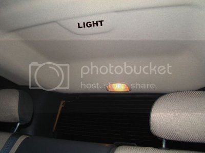

Do you have a factory mounted light in the centre of headliner?
I would like to see what one looks like and was it a push button also?
52400[/ATTACH]"]

Calling HJ- Re Dome Light Above rear seat in Headliner
[/URL]
Do you have one of these HJ?
I see two switches, one per side, a close up photo would be great there HJ. Is this one push button or toggle for this light?

I have an extra... Each one has a push button built into the lens.

Thanks Mark. Interesting, it appears to be identical to the one in the rear or cargo area.
9,241
1,882
I wonder how you would route wires to it though?
Maybe a cable snake?
That would be easiest.
Cut hole for light in headliner, remove rear light, have new wiring ready inside of plastic wire loom tubing, with coat hanger attached, feed to rear voila! :gr_grin:
