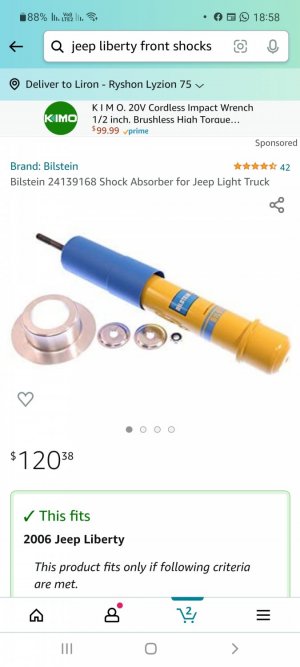

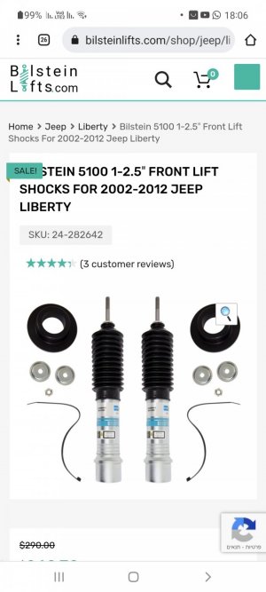

Hi,which one is better for 2.5" lift?

this is what I posted weeks ago on the subject
Anyone thinking or wanting to use the Bilstein 5100 adjustable front shocks , think again
If you do want to use them, not sure why but,.....
You should not install them any more than sitting at the 0 mark, that is it
Any higher and it will create a disaster , degrading the springs within a few months
It preloads the springs which is very bad much like cheap spacer lifts do
These shocks should of never been built in the first place
4600s are cheaper , are the same internally , and are built for the KJs/KKs to keep the same spring perch at stock distances
Jeepinjarhead and I have discussed this and just today I seen a discussion suggesting someone use them
Please do not , unless you want to spend the extra money , set them at 0 just to say you have them
