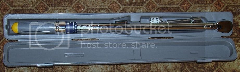

I wonder how often TROY checks his Lug Nuts with a Torque Wrench??
:sorry:IMHO if you don't own one of these and don't have it in the Jeep....
You obviously are doing something WRONG!!! :word:

Don't have one in my jeep and don't use one on my wheels so guess I'm doing something wrong :hidesbehindsofa::jawdrop:
When I was managing tire shops they'd check the torque wrenches against what I did with a 4 way. always within a pound or so
9,105
1,768
YA Tom I may be exaggerating to try to get the point across.
I carry mine simply because, I actually do check my air pressure & torque on lugs often, especially after off road or any highway trips!
It's handy to have it in the Jeep, as... if it is in there..it actually gets used!
I am sure you have great experience with a 4 way...others well..mmm...may not be so lucky, or experienced as you! (that was a compliment BTW)
