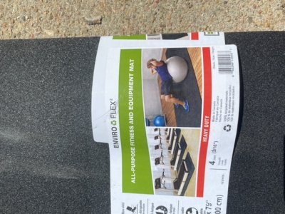

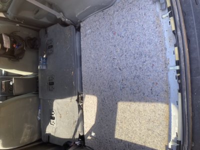

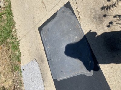

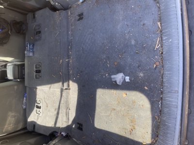

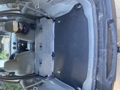

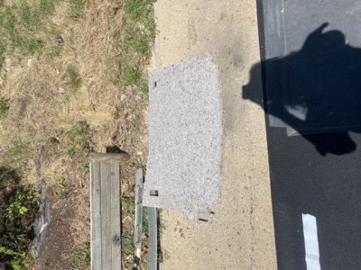

Took me about 40 minutes. No adhesive needed. Re used OE insulation. Upgraded lousy plastic cargo tie downs too.
do it in a sunny day so the rubber is soft and easy to cut.
traced carpet onto rubber sheet, cut with pocket knife while it’s warm.
Easy and cheap. Waterproof and chemical resistant.

I should add that I have been using this same product for the entire floor pan in my current VW bug for over eight years. Is virtually indestructible and cleans easily. I’m planning on doing the seatbacks next, however my push stitcher needs new needles.
This is why there is no hinge flap yet.
