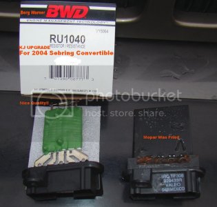

I've heard the same. The one for the same year Sebring is apparently more robust. I put mine in a long time ago and never looked back. Got a cheap Chinese unit from RockAuto at the time.
This is what I recently used...

Can anyone confirm whether the Sebring one changes the fan speeds compared to the original one?
56408[/ATTACH]"]
Got what you suggested, so far so good. Doesn't seem much faster if any than the speeds when the other was working right

Buy the Sebring best & hopefully it wont die like the rest !:icon_lol:
I hope we both get some years out of the BWD resistor ! :gr_grin:

Replaced this today as position 1 wasn't working. Decided to go with the Autozone Duralast Sebring one for $21.99 (JA1464) as lifetime warranty and I had a $5.00 off $25.00 coupon (picked up some needed small things to get to $25.00).
I compared the before and after and couldn't really tell any difference in fan speeds for position 2 and 3. Based on what I think is the date code on what I pulled out, it looks like it was the original one that came with the Jeep.
