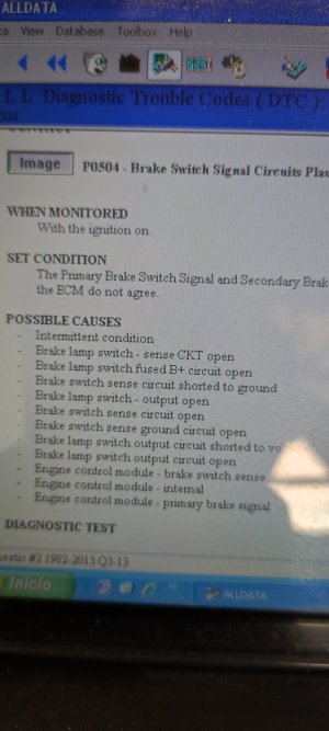

I can't find 2.4 But 2.8 . See attachment for reference
