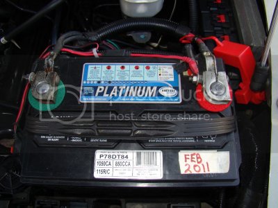

I ordered a new set of battery top post washers.
51781[/ATTACH]"]

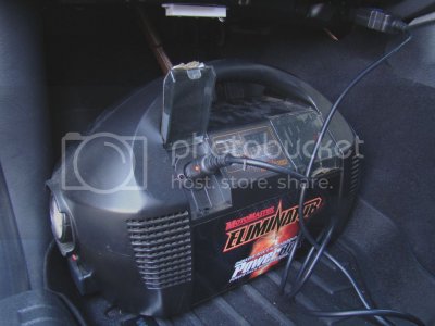

I decided to use my power box and a Snap On Memory Saver, Plugged into the OBD2 Port.
51783[/ATTACH]"]

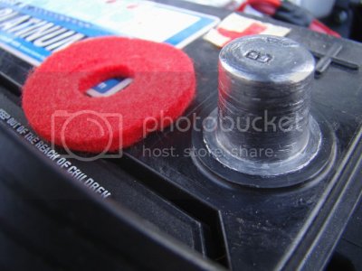

After 11 years the OEM ground pad was toast. You can still buy the Mopar felt pads.
51785[/ATTACH]"]
While the terminals were removed, some emery cloth cleaned them up well.
51787[/ATTACH]"]
