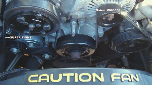

With a new belt & tensioner while pressing inwards, it should be tight and no wobbles while running.

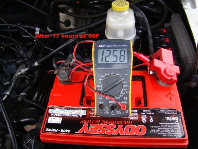

How old is your battery , what model, and what is the voltage reading after sitting all night before starting, with interior lights off/no drain...??
My AM Voltage Reading..
59925[/ATTACH]"]

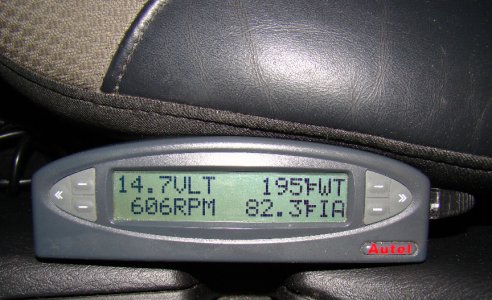

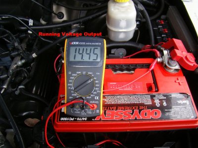

While charging at idle my good alternator shows...
59927[/ATTACH]"]
OBD2 reader shows a bit higher charging voltage..
59929[/ATTACH]"]
Even with a load on driving (lights on, fan on high, stereo) voltage should remain close to shown.
You may loose some amps/volts when ALT is HOT. However charging voltage should not be below aprox 13.7 unless severe load or the Alt is bad.

2,702
241
There is a built in belt wear/stretch indicator on the tensioner if you have the OE tensioner. My replacement Gates does not have it.
