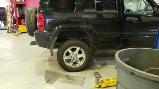

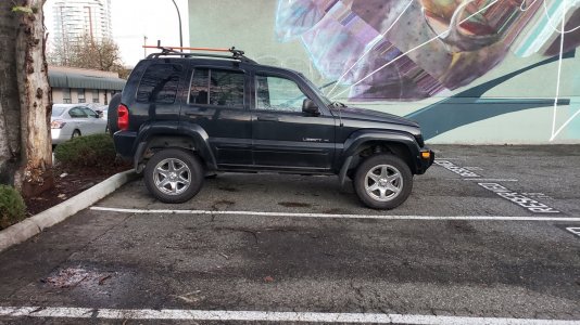

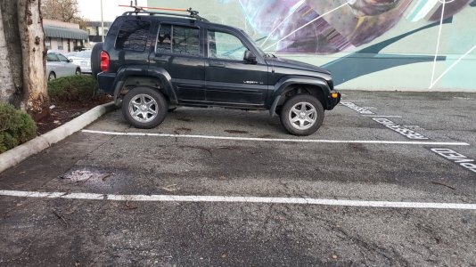

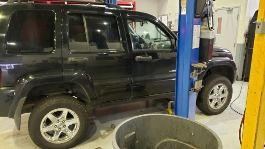

These are my OME springs with Belstein shocks/struts.
Get some Monroe load adjust rear shocks (for dodge dakota) if you find your front end is too high. I got the HD front and rear springs and the rear are not as strong as the fronts even when factoring the engine weight. It stopped the sag when full of camping stuff, wood and boat.

My experience is that even light rears are taller than HD fronts. I have to add a clevis spacer to level the front/rear out.

Thats before and after the load leveling shocks. HD front and rear springs are always in and the rear sat lower than the fronts. When you hit a speed bump with the HD front you know about it. They dont like to compress at all. If I were to do it again I would have gone HD rear and medium front, since I don't have a winch or arb bumper.
