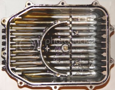

In the photo below these are the particles trapped in the bike's pan after 3000km rebuild, that did not make it through the screen, or drain out the plug.
36195[/ATTACH]"]

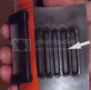

I would think that both iron and steel particles would be trapped by an oil filter magnet, and really this might be a good idea. Here is a photo from Filter mag showing the outline from a cut open used oil filter and the trapped particles.
36197[/ATTACH]"]
36203[/ATTACH]"]
36205[/ATTACH]"]

The Bike had new rings installed and cross hatched, who knows? My thought is that through the rebuild process stuff was not cleaned the best, and the pan shows the leftovers. Glad I pulled the pan though. The bile still runs strong, 6 years later.
If you look closely at the pan you can see where the drain plug is raised. This pan allows for the collection of the particles, but does not get the stuff out, based on this design. Going to pull the pan again in spring next year, and rebuild the clutch as well.
