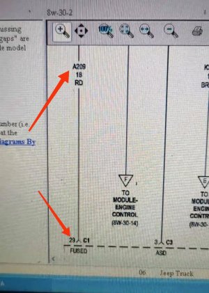

In my opinion, firstly check why there is not 12v on pin 29.

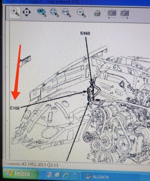

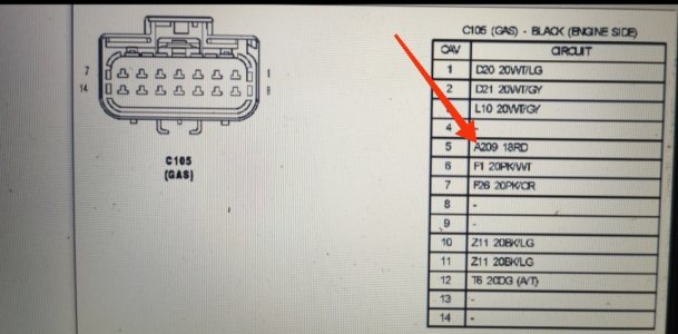

Connector c105 pin 5 12 volts should be present

Engine side of C105 has continuity to PCM 29, verified fuse 24 works and has 12V, however there is no continuity from fuse 24 to engine side of C105 (pin 5). When the fuse is in, I still read 0.2V on C105 pin 5 to Grnd

The A209 18RD cable seems to be open. I opened up the fuse box and can see it goes from fuse 24 to one of the fuel pump relay pins (still 12V leaving the relay pin) then goes into the harness to C105, where it is 0.2V. So somewhere between the fuse box and C105 it must be broken. The harness is all wrapped up everywhere and I can’t see it all when it goes under the radiator. Any advice on what to do next? Run a new wire from the fuse box to C105 would be easiest

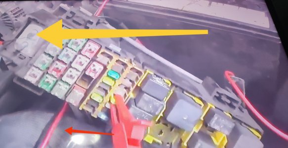

Friendly Advice:
Let's suppose that the cable of fuse 24 is the red one.....(See picture), if you want to know if it's the right one, c you must get continuity between yellow arrow point and the red cable, and if you take the fuse off, you won't have continuity.

I got it working!!
Thank you so much for the help blackhawk and everyone else!
Running a new wire from Fuse 24 (after it joins with the fuel pump relay) straight to PCM C1 pin 29.
