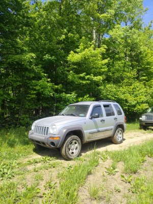

Hello I currently have a 2004 Liberty. Have OME 2948 for the rear and 2927 OME springs for the front. Haven't tossed them on yet because my tires are super tiny.
Current size : 215/70/16
What tire size should I run? Will 245/70/16 look too small with OME lift ? Post pictures !!! Thanks in advance.

245/75 for reference… you will need to deal with the pinch weld and do a little creative trimming of the plastic in front.

245/75R16 has proven to be the practical maximum for me also.

KK the same. 245/75R16.
