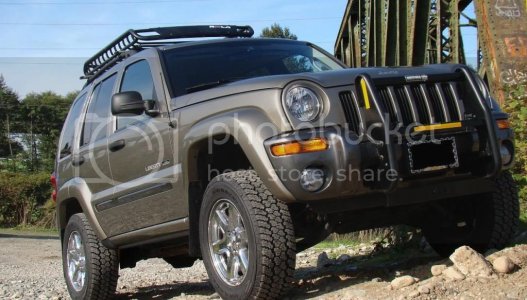

When my Jeep was stock, eventually the springs had sagged so bad, I could hardly get 2 finger's wide, from top of tire, to fender well.
I felt every bump over the road and went to a full 2.5" OME suspension lift and JBA 4.5 control arms+ a tad more in Boiler's steel spacer +clevis conduits, to level the front & rear equally.
The lift section is a good place to read and get up to speed, with what others are doing.
All I can say is after driving an OME lifted Jeep, it now drives so smooth & more like a sports truck, no kidding.
Thing handles like the dickens, good alignment, & Thanks for all of Tom's help, during my build.
Tires: Ya that's what meets the road & most important when it turns nasty, especially with a heavier 2WD SUV and snow.
Find a decent All terrain (AT) tire, many like their Wrangler Duratrac's and the tire & wheel section, has some good brands & info there too.
54238[/ATTACH]"]
I run 245-65-17 Wrangler kevlar Silent Armors, the new ones are now called All Terrain Adventure with Kevlar.
GoodYear Wrangler Tires Link: https://www.goodyear.com/en-US/tires/family/wrangler
The bottom two tires on the site, Wrangler SR-A and Wrangler ST are crap & should only be used as a.....
