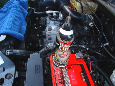

A bit of canned compressed air and grooves cleaning, leaves them all in clean condition.
