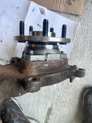

So, the bolt from Amazon (https://www.amazon.ca/dp/B0D2BKXCD7) worked without any issues.
There’s plenty of space for the socket, at least when installing with steering knuckle out, and I don’t see any issue with extra 2mm of length.
(I replaced only one bolt that had stripped head for now.)

Not sure why I thought any of the existing E18 bolts would be reusable ... nothing else has come apart like it should ... both lower control arm mounting bolts were seized, so had to break out the sawzaw ... the upper balljoint nut was seized, so I had to use the nut splitter ... and although the bolt holding the clevis to the lower control arm cam out, it tore off the metal retaining tab ... and then to top it all, CV Shaft wont separate from the hub even with 7 tons of force applied ... At this point the only thing in the front drivers thats going to be original, is the clevis fork, the caliber and the wheel rim!
So I ordered the same bolts from Amazon (same part number) but although advertised as 12.9, when they arrived, the box says "Carbon Steel" and they are stamped 8.8 ... M12-1.75 8.8 bolts are only good for around 60 ft-lb, and those are supposed to be torqued to around 100 ft-lb, you could say, I'm not happy, as it wasted three days waiting for their arrival and a couple more days for the replacements. But I am glad I checked the torque requirements.

@albrandwood thanks for pointing out the torque-spec! I didn't check how the bolts are stamped, and only needed to replace on of them, so probably not too critical, but yeah, I'm gonna replace the Amazon one with the one from eBay - https://www.ebay.ca/itm/235400094399 - seems much higher quality.
... looking at my own photo from above - it's stamped 12.9, so should be good, no? probably wouldn't trust it of all three were the Amazon ones though. Some 12.9 stamped chinesium :-D
albrandwood
Feb 3, 2025
I would expect yours should be good as they are at least stamped 12.9 ... it was more a reminder that just because it was advertised as 12.9, doesn't mean you'll get 12.9, and to always check the head when substituting bolts ... (I ended up using some 12.9 Allen headed bolts)
