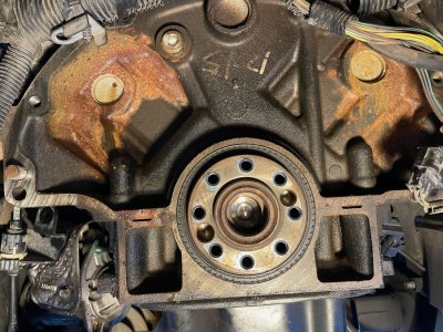

Hey Guys,
I just finished replacing mine. Same issue, significant coolant leak between engine block and bell housing. Attached are the before and after pictures. Purchased the plugs off Amazon. Changed the rear main seal while I was in there.
Transmission removal and rear main seal replacement:

Very inspiring! i’m going to do a coolant pressure test to confirm it is the plugs leaking and begin to devise a plan to change them. Any thing else you changed while you were in there?
LibertyAZ
Sep 15, 2019
Since you have to pull the transmission I went ahead and changed the starter since it was already out. Mine looked old and worn.
