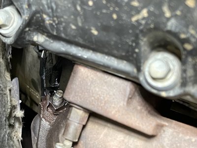

Boy's 06 Liberty's Clutch gave out at 100030 miles...he's headed to a tech college in a couple of months and wanted to get his hands dirty doing the swap. No big deal, we've got all the tools. Until one of the caged nuts on the exhaust crossover uncaged the square nut. Passenger rear...you can see it, but I'll be damned if we can get anything ON it.
It's gotta come out, failure is not an option...any suggestions?

Small Angle Grinder? :rolleyes:
