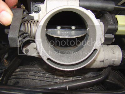

HJ it is not like a seafoam treatment, so you should not have to worry about changing the oil after a quick spray in the throttle body.
Take a peak in the back with a flashlight...most of the time it is nasty. :icon_twisted:
52383[/ATTACH]"]
I believe it is good maintenance to give the TB a quick cleaning.
Even though it may still look good outside, once you spray, you will see some carbon being removed.
The main benefit is the throttle plate or butterfly is clean and will open easily and you will have a Happy Jeep ! :gr_grin:
Add edit: Use MAF sensor safe TB spray cleaner only for the inside of throttle body.
The IAC has to be removed for proper cleaning. I did use lightly some carb cleaner spray,as it was stronger, to remove the carbon on/in IAC.
