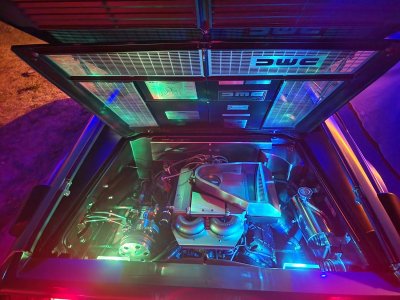

I love that you own a DeLorean. Is yours the stock engine and transmission or have you swapped them with something more powerful?

Mine is still the stock engine and 5 speed. I dont need anything more.powerful. I got nothing to prove and beside's, its not slow or fast for its time. A Corvette of the era was 1.4 seconds fast 0-60. I did add a Stage-1 performance upgrade though and its a big difference over stock with the choked emissions crap. Mine now has a cold air intake into a K&N filter mounted in a larger air box, throttle body spacer and a set of stainless headers that flow into a dual in/out stainless muffler with polished tips. Took 9 long years restoring myself and she is very upgraded. Been daily driving for 13 years and added over 85K trouble free miles. I get 30mpg and still run the original Bosch K-Jetronic mechanical miles. Honestly I never fear it will break and i'm not always easy on her also lol
