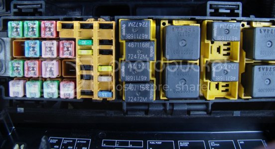

Checked with a scanner and have a P1389 code. No ADS relay output voltage @ PCM. When I look in the relay holder under the hood, I see where it should be, but there isn't a relay holder in that location....

I've no idea why it's not there, but obviously never was. Perhaps that system isn't on all Liberties? I've checked all fuses I can find. Seems really odd that it started fine, ignition wouldn't turn to start, now won't fire once ignition was replaced?
Looks like there has been some serious Monkey business going on there.
58851[/ATTACH]"]

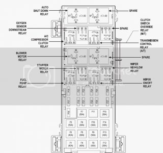

Get a relay in there and see what happens!
This what my 04 panel looks like and bellow the ASD should be a spare!

It's working now!
Ok, so for whatever reason my lil Liberty must be special? It doesn't have a relay for the ASD, nor is there even a spot to plug it in. Looks factory, hasn't been cut etc? Back to the original problem and that was the actuator pin broke and I couldn't turn the ignition to start. I replaced both the actuator and the ignition switch, re-assembled and key now goes to start nicely, but no firing at all. Not even a hint! After several hours testing circuits etc, mega learning and trying to figure this out, I decided to go back to where I started. I removed actuator pin and ignition switch once again. I couldn't see where I had done anything wrong, spring back in place etc, so I put the old ignition switch with the new actuator pin in. Buttoned it up and it works fine. Must be a problem with the new ignition switch? Or I actually did something wrong the first time and succeeded the second time around? Either way it's working once again! Here is a pic of the actuator pin that broke in case someone else has a similar issue.
