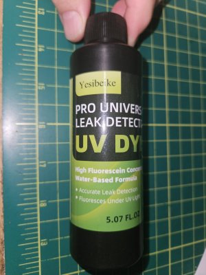

I’ve never heard of looking for water leaks with UV dye. Oil, A/C, but not coolant. Typically you would pressure test with air.
But to answer your question, I’d use the whole bottle assuming it’s the typical 1oz bottle. That’s the amount you would put in the crankcase and it only holds 5qts.

This stuff is purposefully made for coolant leak detection.

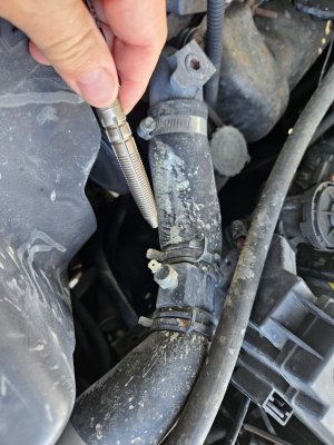

Put half the bottle in rhe cooling res. About to go for a drive to get her to temp and see what the dye tells me. I am about 90 percent sure it's going to be that scabbed-together upper rad hose. There has clearly bees something leaking somewhere.... Maybe? This stuff doesn't flouresce (I may be wrong, but I'm told all coolant would flouresce a bit), and I am known to splash through puddles and mud. It could be flung-off from the fan.
Basically, I suspect the two spring clamps on the switch bung/splice aren't doing the job properly. I will replace them with quality, stainless steel, worm clamps, and I bet that will solve the problem. It's a minor leak, I may just go with Copper Seal if that doesn't work. (send clutching of pearls and gnashing of teeth to /dev/null/.... I have been using the stuff as a prophylactic treatment in every vehicle I've driven for 40 years, with nary a problem....)
Purchase of the new UV flashlight was a good move - it causes the dye to flouresce better than my EDC Olight ArkPro does.

Took a 6 mile ride, got home and there is a little streamer of UV dye showing where I suspected... As well as a very light dusting all over the belt, radiator fan and so on. I may have a pinhole leak in the radiator, can't really tell. We will likely be removing it this Saturday for the AC work, so I will check it out then. Meanwhile, I will get a jug of coolant and a bottle of Copper Seal on the way to work, and dose her on the way back home from work tomorrow afternoon, so it has plenty of time to homogenize throughout a cold (for values of cold... It will be aboit 120 degrees just sitting in the parking lot) engine and find any pinhole there may be.
