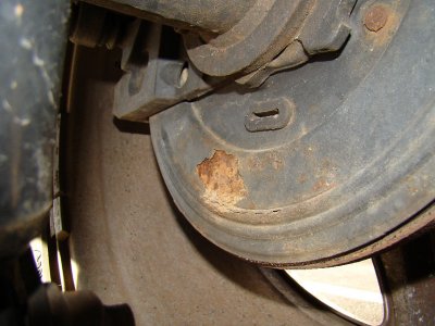

Today was dry & a good painting day. The rear driver's side backing plate was bad.
The small rust spot once sanded today, became much larger.
61406[/ATTACH]"]
You can see the larger rusted area now..
Going to need a few more coats.
61408[/ATTACH]"]
The rear springs both sides, were painted up a bit as well.
This time I used Tremclad Professional spray. One can should do all the touch ups.
61410[/ATTACH]"]
Pushbar and all front suspension is in need of touch ups this year, more work ahead!

Wow that Tremclad pro spray dried very hard & smooth.
Midnight tonight gave it some brush on paint nice & thick.
Color is off a bit it should dry black.
Will give 1 more bush coat, a quick sanding then a final top spray coat as final.
Hopefully it will last a few years after all this paint work ahead.
I certainly don't want to be removing the axles to replace the backing plates!

I'm happy to report the backing plates are restored.
One less part I have to worry about crumbling and falling off the Jeep! :icon_biggrin:
61423[/ATTACH]"]
48 hours since the last brush on coat, then final spray paint today. :)
