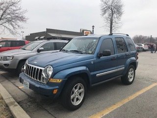

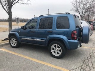

Hi everyone, joined six months ago, been stalking ever since. I bought a 2005 Jeep Liberty Limited back in 2017 with 60,000 on it. Wife wanted it, drove it for a couple years then wanted something different, she didn't like how it handled on the highway especially when it's windy. Now it's only driven occasionally when I need to pick up something where I need to pull a trailer and, in the winter sometimes. It's been fairly dependable with some common issues. Drivers side front lower control arm ball joint snapped while making a left turn, luckily, I was only turning at a green light. I've replaced both front window regulators. Drive belt broke on the way to work one morning in the middle of nowhere, had to limp it 4 miles to civilization. Overheating, had a small crack in the plastic radiator tank, bought a 3-core aluminum radiator off eBay. While I had the radiator out, I went ahead and replaced the water pump, thermostat and housing, idler pully assembly and overflow tank pressure cap.
My front driveshaft went out early on back in 2018, been driving without it ever since. I'm going to order it; anyone have a brand they have had good luck with?

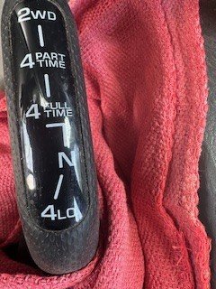

Is there a way I can tell which transfer case, transmission and rearend I have without crawling under it, I'm not real mobile now, in an air boot with five broken bones in my foot. It's a 2005 Liberty Limited, 3.7L auto.

242J tcase, and Chrysler 8.25" rear end. All the V6 autos are 3.73. trac-lok diff optional.

Thanks, up until yesterday I didn't know they had different options. Mine is 2WD - 4 Part time - 4 full time - N - 4 L. others don't have the 4 part time. What's the "part time", is it like a posi, when the drive wheel starts to spin it locks the others in? I've had the jeep going on 9 years and never used the 4x4 because of the front drive shaft being out. in 4 - full time are all the wheels locked in? Thanks

I have both transfer cases. One lacks "full-time".
Part-time is the simpler version where the front and rear driveshafts (and axles) and forced to turn at the exact same speed. The full-time mode tcase has a differential to allow different speeds front and rear, which allows for tighter turning without scrubbing - on pavement.
In the Liberty, the front axle is engaged all the time. (No locking hubs or axle-disconnect).

You have the NV242J t-case based on the shifter.
