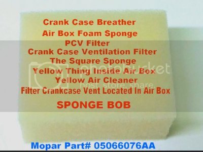

Now I understand why it is so difficult to find a new Mr.Sponge Bob.
The dealer only has the diagram for the outside of the air box, not the inside!!!
Ya know, I could have said each one of these things, and they still could not come up with a part number!
So here is the part still available today Mopar 05066076AA
55178[/ATTACH]"]
55180[/ATTACH]"]
I could not easily find part #for some reason on our site here either.
I don't know if the new filter comes in box or plastic bag, but will get to have one tomorrow.
Hope this may help others who want to replace theirs. :gr_grin:
How I found it Link: http://www.moparpartsoverstock.com/p/JEEP__LIBERTY/FILTER-Crankcase-Vent--Located-In-Body/6743977/05066076AA.html

LMAO!!!! With shipping, it's $17.82. Why not just go to Hope Dopey, buy a sponge for 2 bux, and cut your own. Hell, for that price you could make a ton of them, sell em on the street corner, and retire.
9,242
1,883
I am not paying $17 for it. It is how I found the part number.
Coming locally from dealer warehouse. $6.
Other vehicles used these, incl PT Cruiser.
"Sponge Bob"...........forgot about that thing and don't remember the last time I even checked "him". I do remember pulling "him" out once by his ears and giving "him" a good bath and washing "him" and ringing "him" out and putting "him" back.........wonder if "he" is still there?........LOL

I found a generic breather filter at Auto Zone and trimmed it to fit. Think it cost me $2.20. But thanks for tracing the part number down and sharing.

Do you know what years were these included on Tim? I do not recall seeing one on my 2003 last time I checked the K&N?
9,242
1,883
Not completely sure Matthew, but I think 04-05's for sure, also same in Pt Cruiser.
If you don't have the slot in air box for it, don't worry about it.
I'm back home now after dealer & got the new Sponge Bob installed.
The old one was was starting to crumble, just like we will in old age! :icon_lol:
55241[/ATTACH]"]
It appears yours has spent a little too much time on the beach! :gr_grin:
Care to share the brand and part number? I see Fram BA6662 might work and only $1.50 at Advance but not in stock locally.
