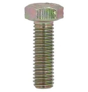

Hey All,
My 03 Liberty needed the blower resistor replaced. Unfortunately, the screws got misplaced. I am trying to find the exact size so I can track them down. I know the head is an 8mm. Any help would be greatly appreciated.
ScottZ0
WWDiesel
Dec 15, 2013
80
69
Central Georgia
If the head is 8mm, the screw size is most likely a 5mm x 0.8 thread if it was a threaded bolt and not a sheet metal thread type screw.
It could also be a 4mmx0.7 thread bolt with a 8mm head. I would buy one of each to be on the safe side.
Most hardware stores carry small metric bolts.
