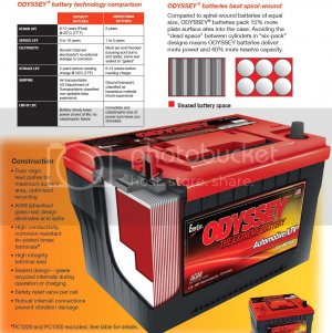

If you want to eliminate venting get a Sealed battery or an AGM absorb glass matt battery.
They wont vent or cause corrosion problems...The Odyssey is the best.
49015[/ATTACH]"]

I like my box photo better ...it even comes with a sticker! ha ha..
49023[/ATTACH]"]
